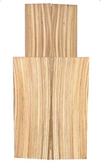

This is the picture at LMI of thier zebrawood - thier sets are $74.00 or so - I find this board has much nicer figure - serious its more akin to that black and white ebony that was around a while back and went like hotcakes - only reverse the black and white.
The black lines on this piece Im thinking of buying are sparser more sporatic, and wander around back and forth.
Cool even if I get 3 sets it will be a good deal, I figure<no pun intended. charliewood38841.6213425926

If you get a look at the end grain, remember that if one edge is very well quartersawn, then that edge (resawn) will make a good bookmatch for the backs, even if the rest of the grain falls away from the quarter. And, try to sort of extrapolate the amount of width in the board that is quartersawn (radial shrinkage is about 7%), and the amount fully flatsawn (12% shrinkage, yikes!), and how much is somewhere in between those extremes.
Without looking at the endgrain, I'd be willing to bet a tub of lard that in this picture of Zebrawood, the bottom edge of the board is rift, approaching quartersawn, and the top of the board is approaching flatsawn. Hope this helps!
